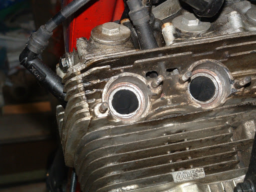

  4. There's no insert in the head. Looks like someone didn't realise there
    were still existing gasket rings in the manifold and just bunged in
    another set. I've seen it before.
    Lever them out with a screwdriver blade and carry on.

  7. I know I have, having mistaken severely crushed gasket rings for the
    manifold casting itself.
    The Older Gentleman, Apr 4, 2010

    On my 250LC, I deliberately put on 2 exhaust gaskets, as with just one
    it started leaking too quickly

    On my RD there are two copper gaskets and two flange gaskets, it's the
    only way it will seal at all, and has been the case on every RD I've
    ever had, doesn't make a difference if they're pattern or genuine parts
    either.
    I sent the CB head off for blasting with the gaskets in place as I
    didn't see them, and I only just noticed when putting the exhausts on,
    bit of a rummage with a pointy thing had them both out.
